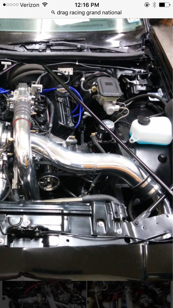

Don't know if I'm in the right forum area or not but I'm looking to make a custom intake. Does anyone know what angles to use? Looking to build one just like this
If you want to duplicate that yourself, you'll need to be able to weld aluminum. Do you have a TIG rig?
If not, it would be MUCH cheaper to buy one from somebody that's already done the dirty work and sorted it out.
That's also set up for a SD type system, do you use a MAF?

I have access to a tig. And I'm going to be putting the MAF right at the 90
Looks exactly like the GN1 intake just with an extension through the core support.

Might want to rethink that MAF location. Having it at a 90 might give you some screwy readings. While you're planning it out see if you can get a straight shot before the MAF for a little more consistent flow stream.
