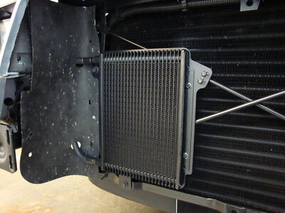

Where’s yours mounted at? Front of the radiator?
There's only one place to mount one where it'll get any airflow, and without airflow it's a heat sink, not a radiator.

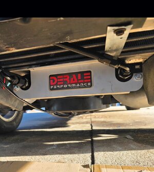

I have mine mounted to the core support just below my ESP front mount.
Sits inside my box in set-up from GNS. So it still gets the airflow from the grill.

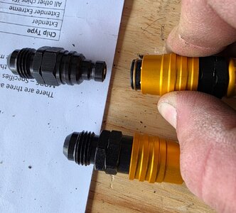

Ive got the 13960 on mine with the jiffy qd and -6 an lines to trans.
