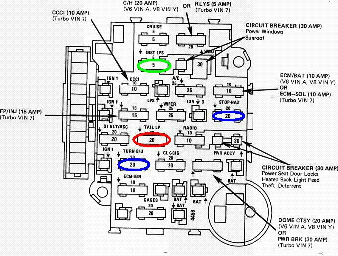

I had the same problem beginning of the summer check your fuse box there are two fuses for that check your connections and your fuse box very thoroughly my problem was a blown fuse that controls the dash lights

my gauge lights worked also but they would do the exact same thing yours is doing bright no headlights on dim no adjustability with the headlight switch on

Do you remember which fuses they were? I tried looking last night and could not see the dash light fuse or fuses.
I'll take a pic tomorrow off the top of my head it was in the middle of the fuse box more towards the top

Here's one of the links that got me headed in the right direction on my car when I had the same problem it's hot air not ic but it worked for me fuse location pics will show you exactly where the fuses are

Man I was lucky, I found a blown fuse and replaced it. The dash started working correctly again. I also repaired the shift light and now every thing works. Thanks to all for the help. Cant get under the dash like I used to back in the late 80's with my first GN. :(
