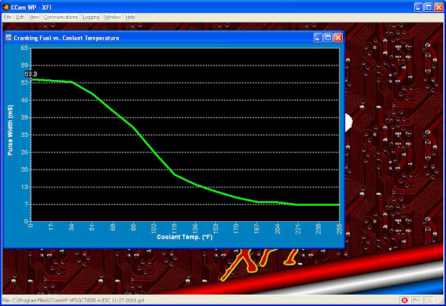

here is my cranking fuel table
remember the colder it gets the more afterstart fuel youll need as well to keep it running!
-Dan
Been wondering if I have TOO MUCH fuel at low temps, tried using lower values (closer to 20 ms) last weekend without any success-- still took a WHILE.
At 120#ers I do have big injectors. May just need to tinker with this more, or it just may the difficulty of dealing with chemical properties of E85 and cold temps.
^ i would tweak that table for sure. i dont see it needing that much. 20-30 is about right
Also, make sure you have your fuel energy constant set to .680 It uses that value to trim your cranking fuel table. I'm pretty sure you are flooding the engine with those values.
