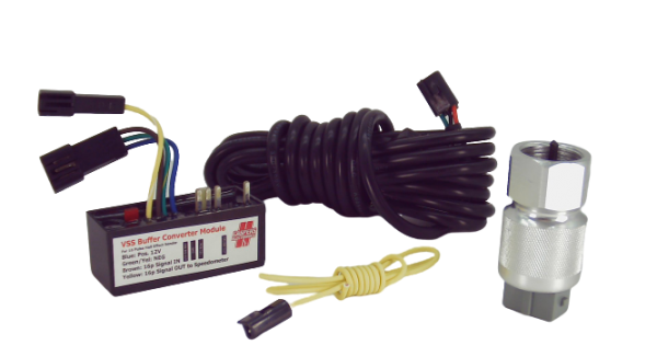

I have an 87 GN powertrain that I am using with the GN 2004r in a swap. I know the Cluster provides the speed signal to the ECM. Do I need the signal? Not sure if its required for TCC lockup. I do not have/ need cruise control.
Is this what I need to get the correct signal to the ECM?
www.casperselectronics.com
VSS Buffer Converter Module Kit WITH Sender
This kit provides the required 2000 pulse per mile signal to the Turbo Regal ECM, along with the correct cruise control signal to restore normal cruise function when installing an aftermarket dash (or GNX style dash). The sender in this kit is a 16 pulse-per-revolution, dead-end style and all
