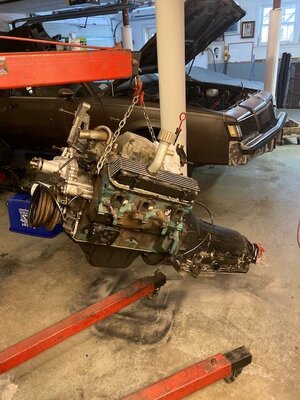

I dug up old pictures from almost 30 years ago
From nineteen hundred and ninety five.

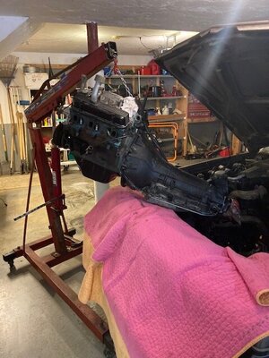

As harbor freight is a bit of a drive, I thought what the heck try it with what you have, where you are. I guessed on the angle and got lucky, went in at about 30 degrees nose low with some jimmying. The starter and exhaust were a little in the way but not a deal breaker. My wife was amazed that there was no swearing!

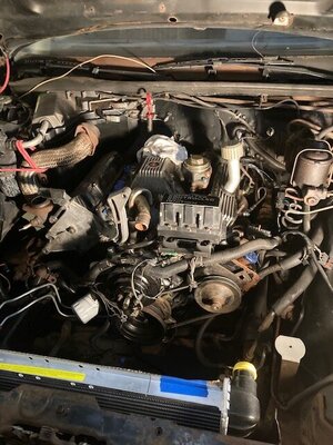

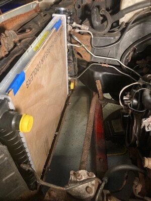

Thanks, the only thing I screwed up were the trans lines. Total pita, ended up getting new lines from inline tube (86-87 instead of 84-85 but that is another story). Had to jack the motor up to slip them in between/under the engine and past the motor mount. If anyone orders trans lines form them beware I don't think they know the difference in radiators (but maybe they sent me the wrong tubes) . I bent up the last 6 or so inches of the radiator side and the fit on the trans side was perfect.

I wish my engine lift had a boom that long. I have one of the "standard" ones that seem to be the majority of engine hoists. I think it's a Big Red. Boom is too short to come out or go in from the front. I had to go over the fender to pull the engine. I plan to make some leg and boom extensions to make this work easier for the Buick.
