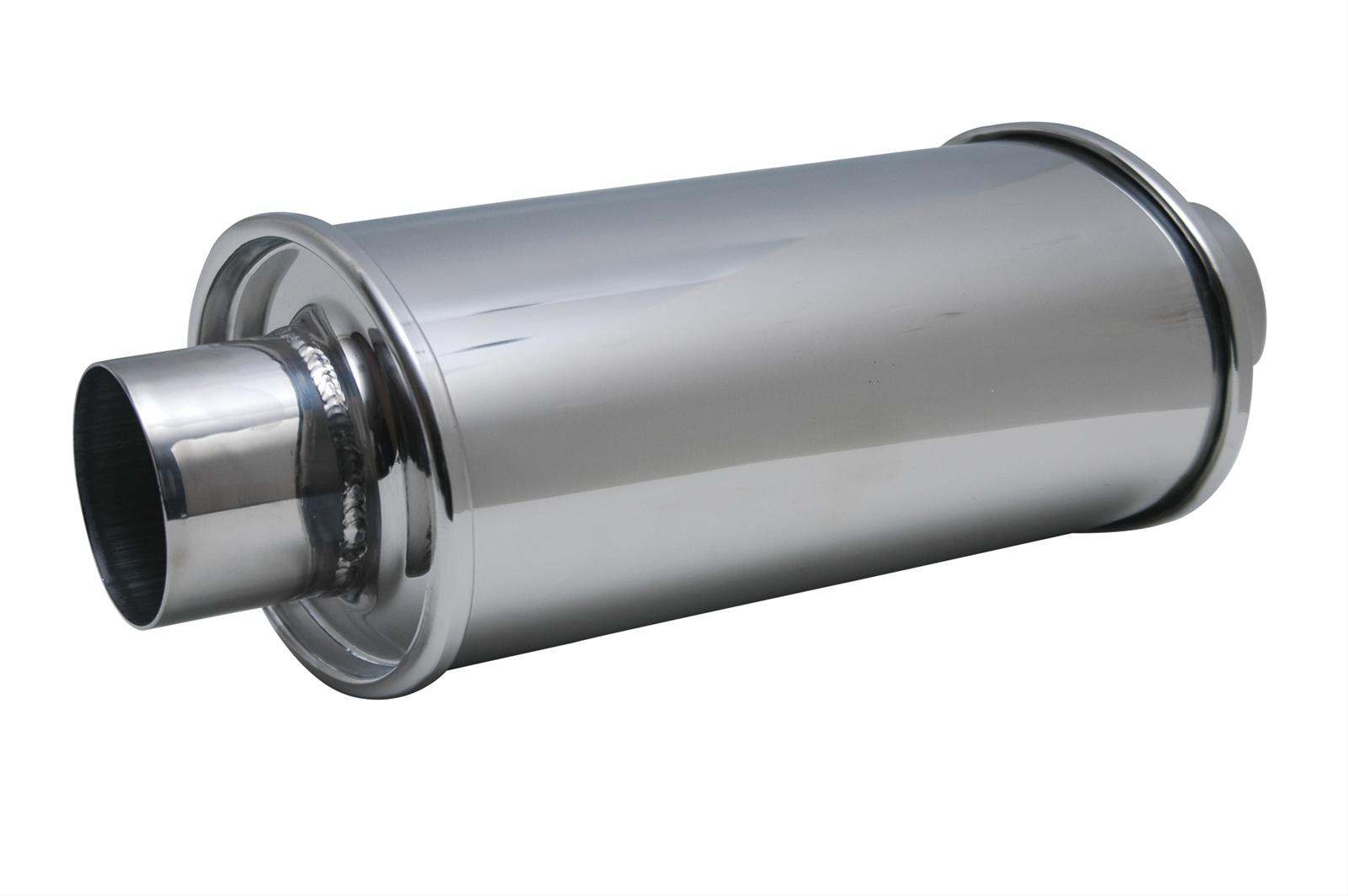

I would suggest Vibrant’s ultra quiet resonators.
I’ve used them over the years to quiet down exhaust systems.
I’ve tried them as mufflers on my ‘94 Olds Cutlass Convertible 3.4L DOHC, a little too loud for a Vert.
Some have compared them to the ATR Pitbull mufflers for the ‘86-‘87 TR.
They are very deep toned and I think they would sound great on a turbo car.
The case is 304 polished SS (case size 5”x8”x 10” L. [14” overall]). One review said 409 SS perforated inside tube.
Check them out.
Check them out.
I finally ordered a set of these. The blown out muffler was finally getting too annoying. Even if it doesn't quiet it down, at least it won't be dumping the sound directly under the car.
I'll admit that I am shocked just how much the resonator changed the sound. It is more like a smooth "hum" with a slight rumble on the side I replaced. The other side still has a 25 year old Midas muffler and seems to have more of a "snap, crackle, pop" sound. I'm not sure yet if I will even like it, but something needed to be done. In hindsight, I should have just tried a straight pipe first since it would have cost almost nothing.

I was hoping you would report back with your thoughts.
Do you think it’s too quiet or just a different sound?
Need to wait for rain to stop to take it for a drive. Initial thought was too quiet, but I'll update after a drive. I was surprised to see that the Midas mufflers I pulled off were a straight thru design instead of having baffles. They were install in 93 and Midas said "Too bad" on the lifetime replacement.

Yea, it's too quite. I shouldn't straight piped it and saved the $$. I was hoping for the low rumble like my cousin's WRX. Little 2.0l has a nice low rumble and not just sure how they do that.
