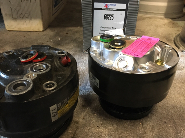

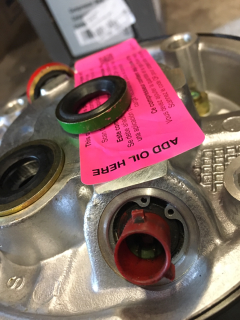

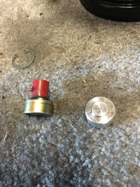

So I bought a four seasons 68225 compressor and going to install it. First thing I notice is that it does not have a harness connector on the back of the unit. The two prong round clutch switch?? Is this normal or what? Next the four seals two red, green, and one nickel. The nickel plated washer looks like it goes on the wide port. So then do I use the wider green washer or thinner red washer?

Snap ring pliers, remove the pressure switch from the old compressor, and swap to the new one...
Do not use the red sealing washers..I lightly used rtv on the sides of the washers to hold them in place...lost one last time I swapped compressors..
Pretty easy job to swap compressors...
Read the tag on the compressor, I believe it has oil already installed..I added a couple of oz to the accumalator also.
That's done!! The tag only says it pre charge with3oz of oil. You added oil to the accumulator which is the dryer canister right?
Correct..I would add about 3 oz..to the accumalator/dryer.
