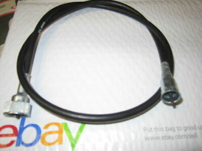

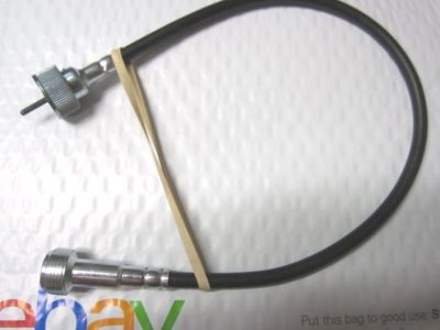

I just purchased a 2 piece replacement (upper & lower ) speedo cable on ebay, will post a link.

Looks like the vendor of the replacement 2 piece speedo cable is asking me for each individual lengths of (both upper & lower) speedo cables! Guess he makes them to order. Can anyone confirm upper & lower lengths?
The one I have measures: Upper 35 inches , Lower 49 inches
