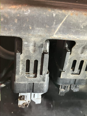

I’m making something simple complicated, but how do you remove the relay for replacement? I removed the bracket that holds the 3 relays to the passenger fencer. Pic is the back of the bracket. Looks like the relay should just slide down to remove it, but mine doesn’t budge. Help out the old guy. Thanks.

The center of the brkt has a "tang" locked into the side of the relay.
A small screwdriver, lift the tang and take the relay out.
Got it. Thanks. Then I couldn’t get it unplugged. The factory really liked that black tar stuff!
