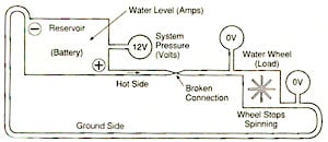

Just replacing the Relay module may or may not fix your issue. The female connector terminals in the plug can be corroded or damaged which can cause intermittent contact. Here’s a better solution which is reasonable priced :
