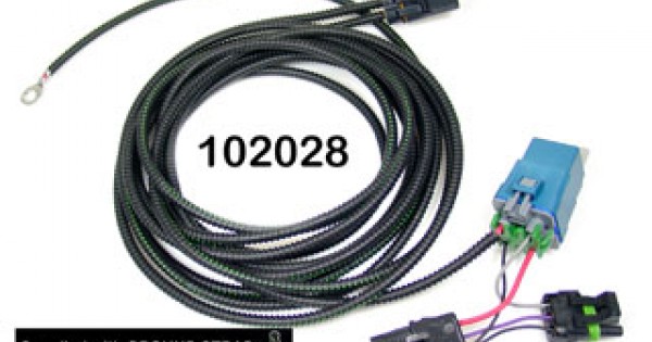

Where do I find this hot wire kit, and instructions for install?I can tell you they're short of parts, just like everyone else...
Last week, a June 18 delivery for a Walbro 255.
Thanks for the updated information. I also saw another kit that increases voltage at WOT to 2.2 voltage.you can find one at the following location.
Fuel Pump Wiring Upgrade 1984/1987
Fuel Pump Wiring Upgrade 1984/1987Absolutely essential upgrade item for your turbo car! Increases fuel pump volume by 15% or more! By far the finest 12 gagewww.casperselectronics.com
