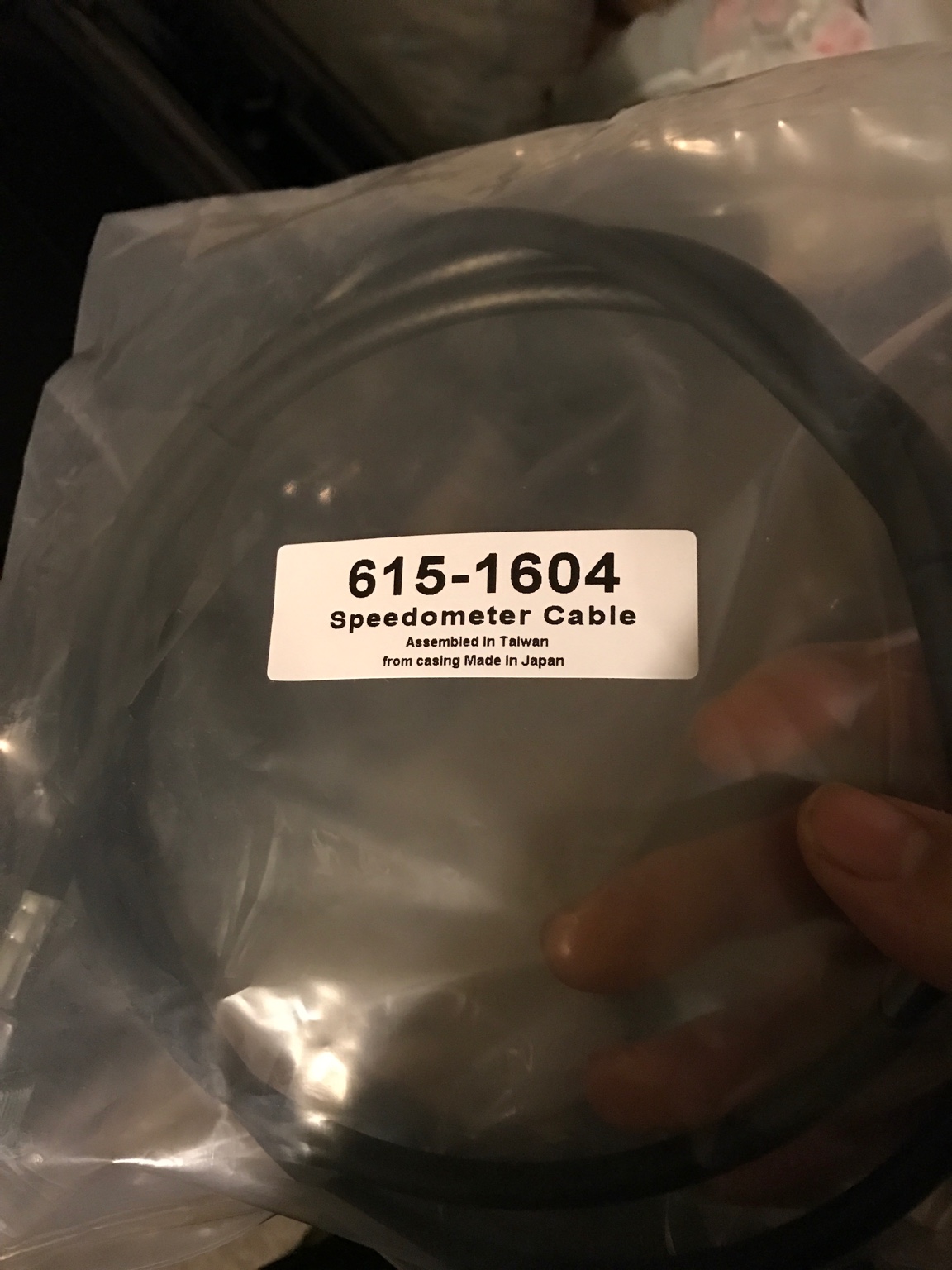

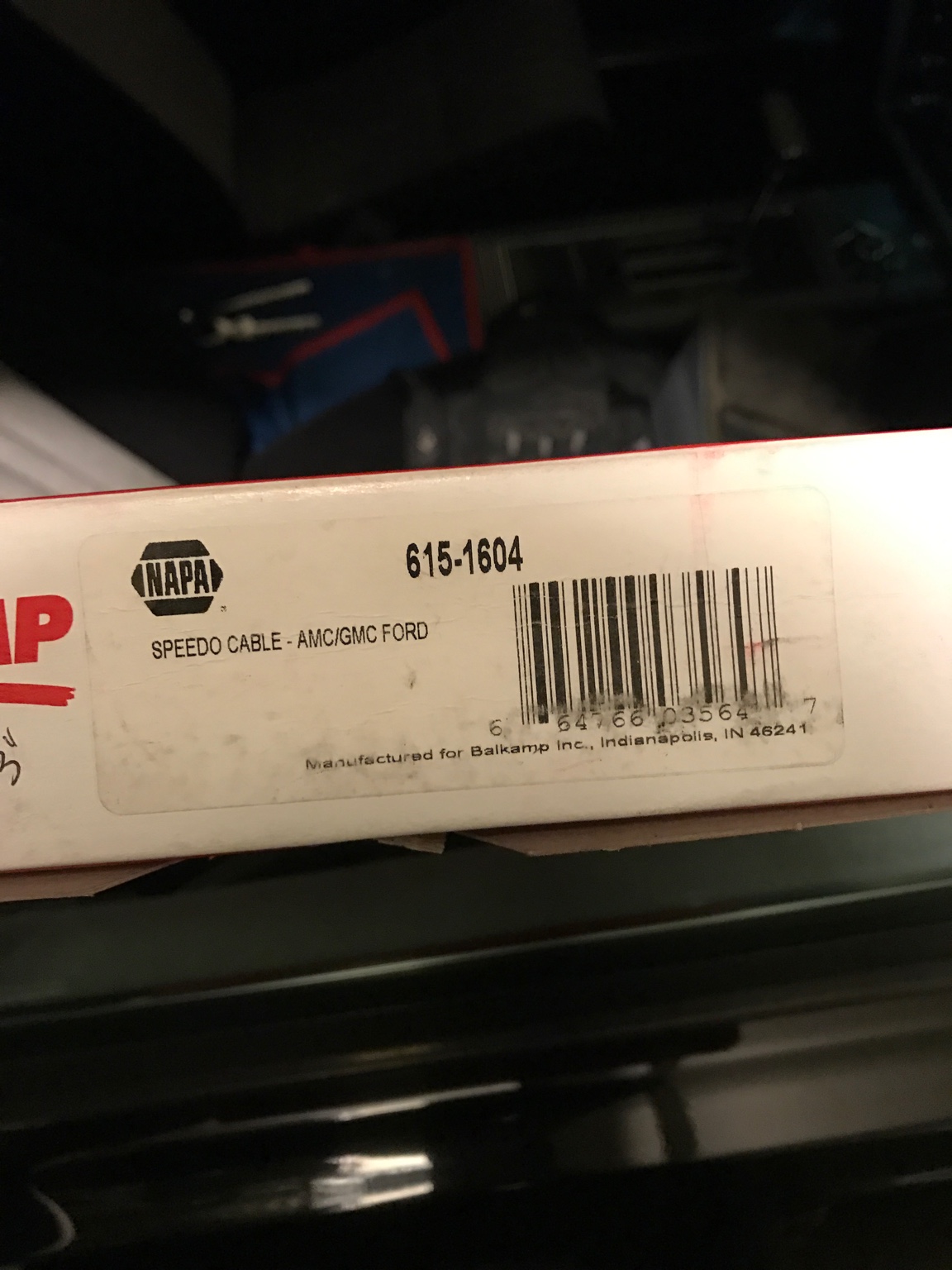

For the next person needing this I got it at NAPA for 9.00
that cable is 64" long , going to be a little long for use as an upper
A little long, but they had in stock GN has been apart for about a week and half... couldnt wait!
