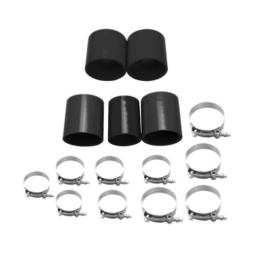

Looking for HD clamps for the up pipe. Already have HD silicone, but they keep blowing off. Tried the hairspray trick. Usually blows from the doghouse connection.
or
TIA
Search for Heavy Duty No Hub Coupling with the 4 clamps and metal liner. I put this around my hose couplings and it holds well for me.
I've got a bunch of stainless steel T-bolt clamps I send out with my kits.
If you can flow off couplers with these clamps, you're doing something wrong.
What clamps are you using now? Cheap worm clamps?
