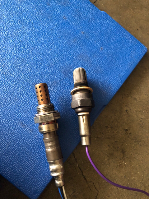

Just installed the 02 sensor with the Caspers harness. BIG PIA.... but well worth it! The old looked pretty bad and all the carbon smell went away, and the nest didnt go off at all.
Old vs new. And I swear I drove for a bit and felt alot more responsive on the throttle. Maybe just me because I havent driven it and was just excited to get atleast a little test drive around the block.
