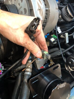

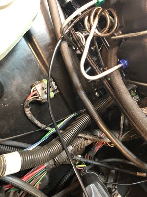

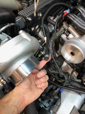

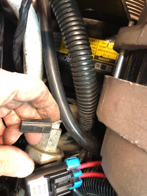

Ok, this may be all the questions. I have a bunch of connectors from the stock wiring harness that I'm not sure go to what. I'm pretty sure the one next to the hydraboost went to powermaster. One of the two that are in a pic together may be a temp sensor as I'm using a different temp sensor for my new gauge unit. So, let's see if you gurus can ID each of these connectors in the pics.

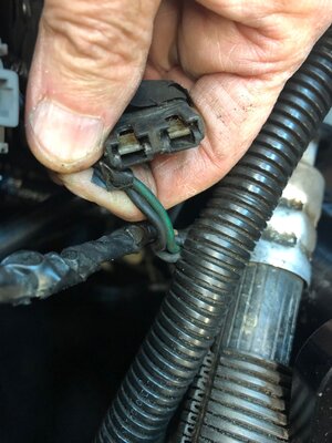

#2 looks like the A/C compressor clutch connector, should be a diode on the back of the connector across the two leads where your hand is.
#4 the single wire with black connector looks like the fuel pump jumper wire . Put 12v to it to turn on the fuel pump .
Well I guess I don't need that one as I have the hotwire kit and my fuel pump works fine now.
You'll want to keep that as-is. You can jump it to the alternator to run the fuel pump(s) if ever replacing the pump or lines to check for leaks without having to start the engine, or for diagnosing a fuel delivery problems in general.
