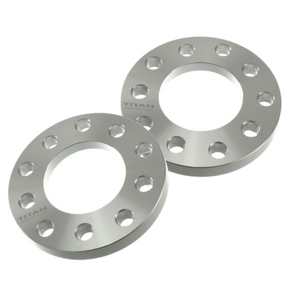

These spacers pilot on the bolts and would be good ones.
I couldn't find any with any with a 70.5mm center bore and hub to pilot the wheels.
The UMI Performance Green Machine uses wilwood aluminum hubs that don't pilot in the wheels and they road race and auto cross it with no troubles.

The spacers you showed me don't look to be hub centric. Is that a problem? I researched them and like you said the hub centric ones would be better but I can't find them. Would it put to much stress on the studs not being hub centric? I'm not going to be racing or anything just cruzeing. I didn't even think about rotating tires that would be a good idea going 18x8 all around.

The wilwood aluminum hubs don't have a pilot flange on them, the wheels center on the wheel studs (lug centric) and they seem to be good.
I figure if non hubcentric spacers hold up to road racing, they should be good for anything.
The spacers with holes instead of slots should have less chance for vibration.
