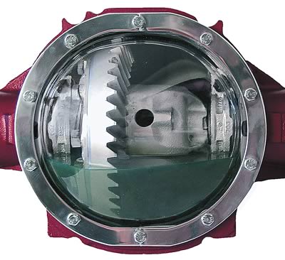

For far out factor, Trans Dapt has a clear diff cover part #8402.
