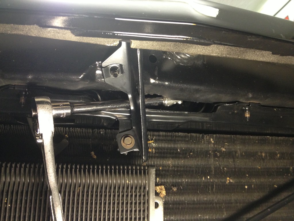

You can go in through the grill area. There is an opening in the core support and you can see the two 13mm bolts that hold the latch to the core support. You'll need a thin wall socket on an extension. Just unbolt those two bolts and the hood should pop up enough to allow you to disconnect the cable. Here are a couple pics I just snapped of the area I am describing.
Thanks for the reply's and pics guys! I was eyeballin those 2 13mm bolts to thinking hmmmmm. Well if those 2 don't work I'll have to get the chain saw out! :) Off to work I go!

Hood is open again! :) Thanks John Larkin your way worked like a champ! The secret is a short 13mm on a swivel adapter along with an extension! The only thing I would have done different is I went for the easy bolt on the left first and when I went to do the other one, when it was just about all the way out it twisted around and I had to get some needle nose to get the last few threads out. So that turned into a pita. Would have been easy to handle if I took the right bolt out first then the left as you have more room to play on the left. The main problem I have is it's a show car and everything is powder coated or recently painted so minimal damage was key! I made a few marks on the underneath of the header panel but it can't be seen. Thanks again John for taking the time to post and post pictures no less!

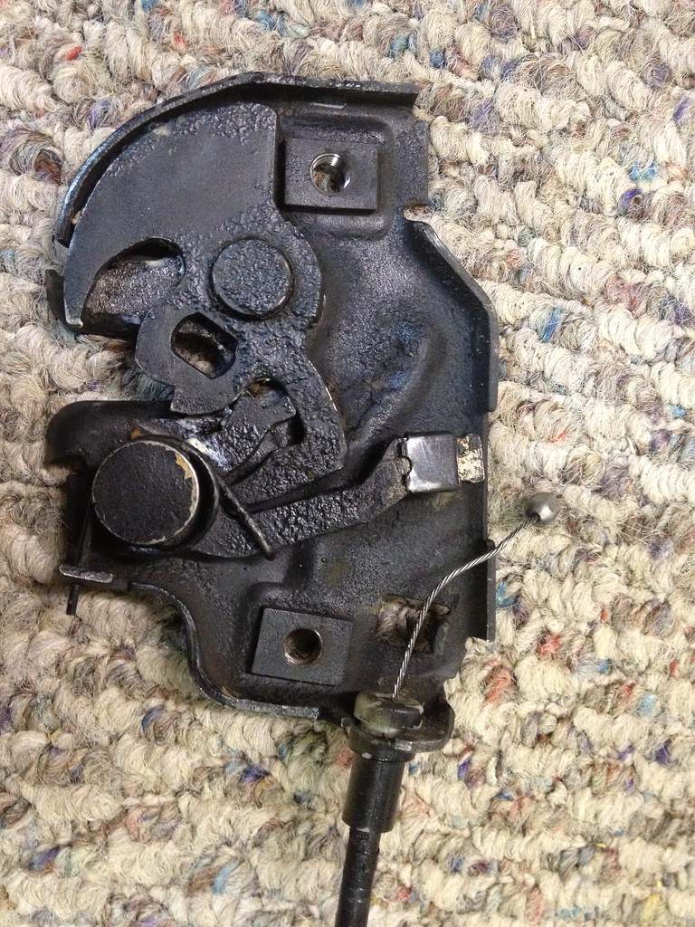

And here is what happened... The little tab for the cable must have broke off! So the cable might have been fine. I just need a new latch now or that little clip. I would think more people are going to run into this over the years as that tiny clip can be bent so many times. No less if the car is a driver I would think that part will get rusty and break in time! Funny part is I was going to replace or chrome this latch when I had the front of the car apart because it was so nasty looking. But this is the back side you don't even see. So I figured I'd change the latch out over the winter... guess that bite me in the ass!

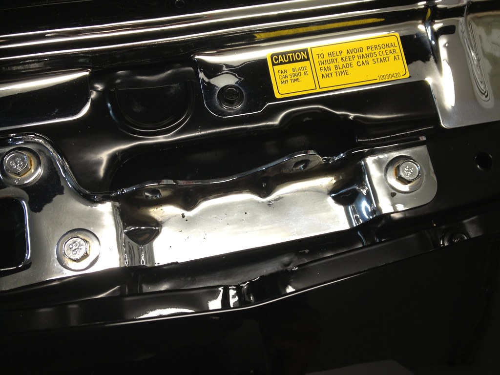

and here is the end result...
