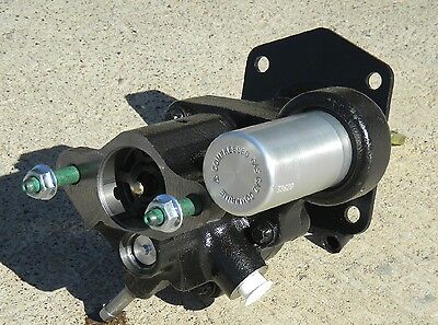

Looks like you guys grabbed my attention on this post for sure. Just blew my stock booster, and in desperate need of an upgrade. Was never a fan of vacuum, and cant find the cardone 52-7211 anywhere. I make my own lines as well, so this should be a pretty direct install, assuming I pick the right cylinder.
The pic.........again, since the crash appears to make the original unavailable.
