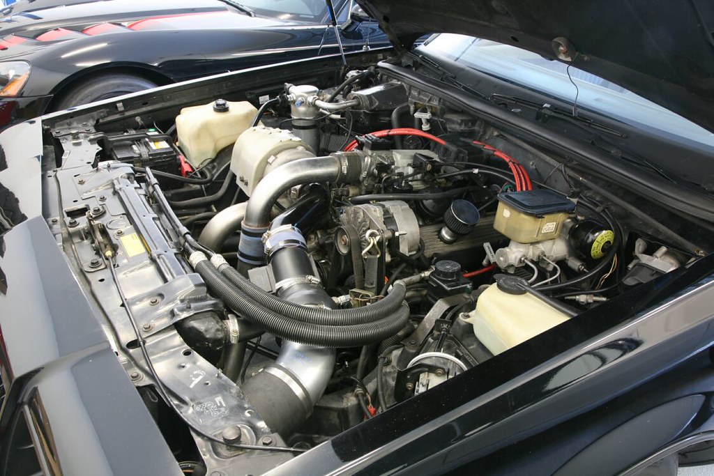

Here is a pic of the engine. And I'll throw in some updated pics of the car including my 'modded' interior.
How far down does the filter go did you have to cut facory fenderwell or anything or did it just fit right in?
The filter goes down to where it's even with the plastic 'skirt'. Not sure what that plastic piece is called.
Didn't have to cut anything. There was a small piece of the core-support that I had to bend. It's behind the head light and looks like a little tab for which to connect a ground wire to.
It pretty much slid in place. The rubber boot that connects to the MAF already had the hole for my temperature sensor. Easy install for sure.
I can't believe I'm getting away with 20 lbs of boost with no knock showing on the powerlogger. I'm only running 93 octane with NO alky kit. :eek: I do plan on trimming the boost back to 18, just to be on the safe side.
