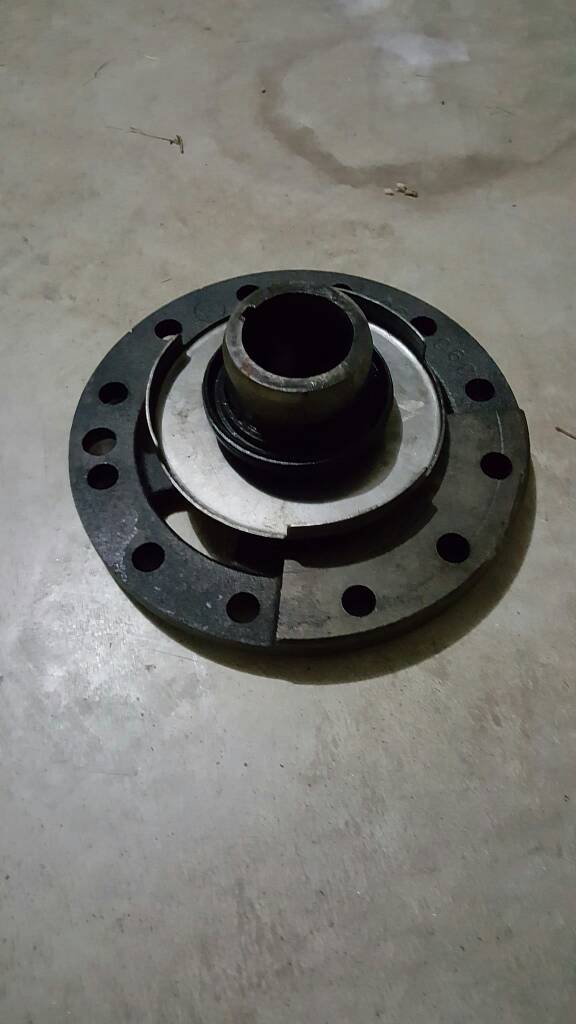

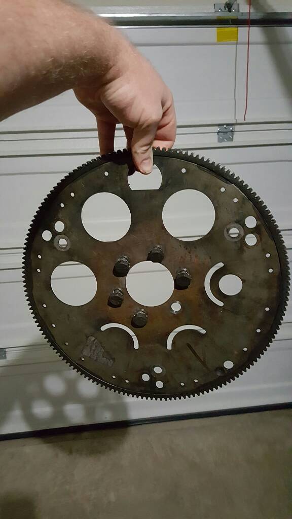

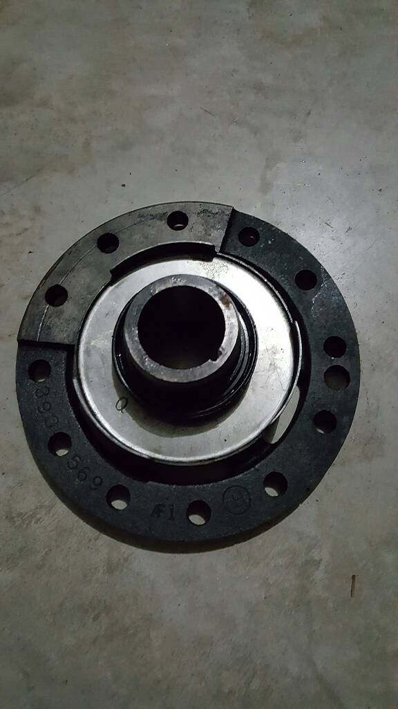

I am rebuilding my engine and I believe I need to purchase the externally balanced crankshaft.
I have attached a picture of my flywheel and harmonic balancer.
The harmonic balancer looks to have a weight attached to one side.
I assume this means the rotating assembly is externally balanced?
Thoughts?
Thank you so much in advance.
Yup
If you went aftermarket internal then the balancer would not be counter weighted

From pure cost perspective:
The flywheel and ring gear are not cheap so, it's a bit more than $120 in the end.
Don't really know if there is a real benefit at power levels that will crack a 109.
