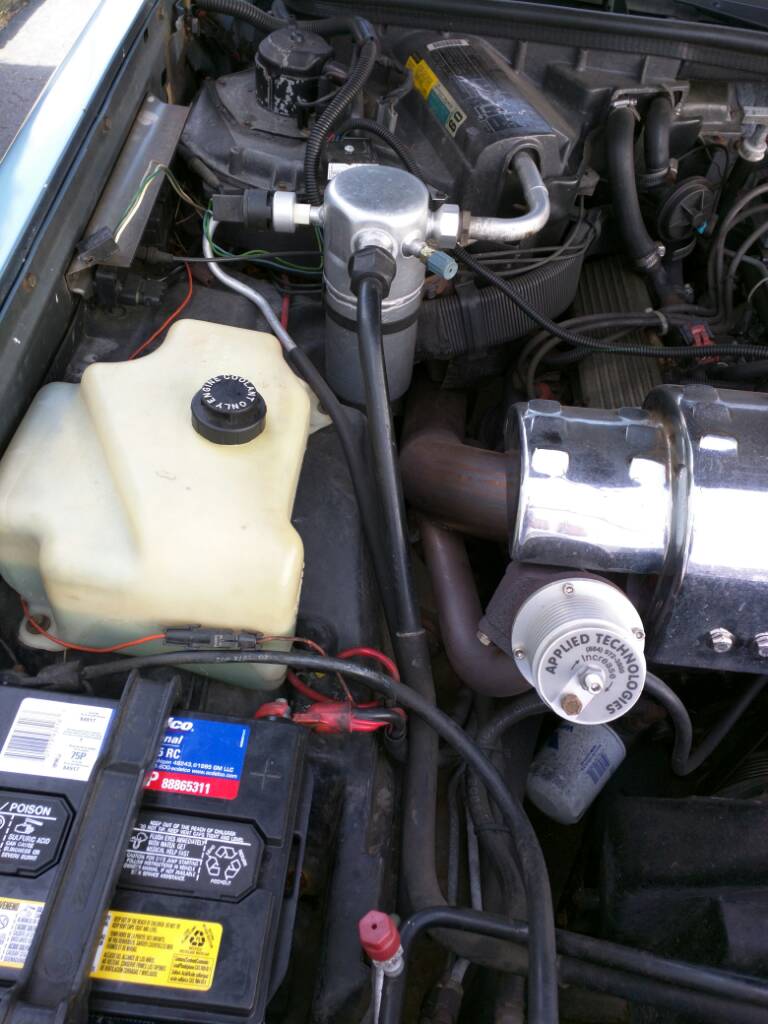

this is what iv got. Boost is stuck at 9/10 psi, no matter what adjustments I make. I have the stock adjustable unit but I'd have to buy another downpipe to make that work, and I really don't have the budget for another dp right now. Not looking to go 20lbs of boost or anything but would like to bring it up to 12 or so I don't think 9/10 was stock for these cars.

The gate is as rusty inside as the outside, and the shaft will never free up enough to be reliable as this issue is over 20 years old with the ATR gates.
Do the right thing and trash that gate and replace it with a modern one which uses a stainless shaft like the Tial gate which is a bolt-on piece.

Your pipe is configured like the new TA external gate pipe which uses a Tial 38mm.

Take it apart, clean it up and make sure the diaphragm looks OK. Contact Kirban if you need a new diaphragm, as I heard he bought some from Richard Clark. Also make sure you don't have any exhaust leaks. I have an atr wastegate and can make 24 psi no problem.
Measure the distance between the flanges. I have a Turbonetics Race gate in great shape that should fit

Tial 38 is a direct replacement. I have the same downpipe and made the switch years ago and even made a couple bucks selling the old w/g here.
