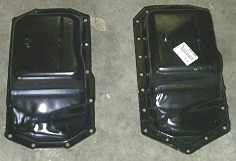

Jul 29, 2007 #1 TR Custom Parts Mark Hueffman - Owner Joined May 25, 2001 Messages 12,735 Part # is 25505746 Attachments 9418_1.jpeg 22.5 KB · Views: 109
Jul 29, 2007 #2 8 86 TR Work In Progress Joined Mar 9, 2007 Messages 1,074 No. That is for 85 and earlier. The pan you have is a 14 bolt. The oil pans used on the 86-87 is a 20 bolt pan.

Jul 29, 2007 #3 J johnnyttype Active Member Joined Apr 18, 2007 Messages 1,313 no, im pretty sure that my 86 has 20 bolt holes not 14 and the front of the pan should come to a point, not a flat edge like in the picture.

Jul 29, 2007 #4 8 86 TR Work In Progress Joined Mar 9, 2007 Messages 1,074 Here ya go. Oil Pan Photo Guide
Jul 29, 2007 #5 J johnnyttype Active Member Joined Apr 18, 2007 Messages 1,313 the 14 bolt pan on the left and the 20 bolt pan on the right
