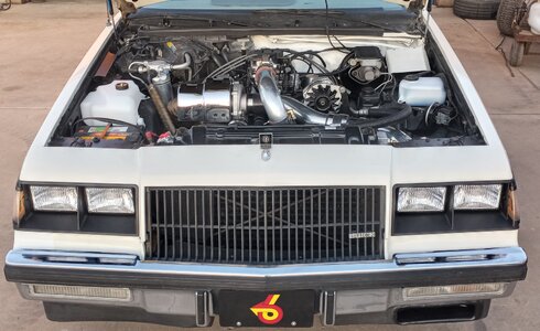

In the tuning phase right now. Fuel pump issues, I'll replace that tomorrow, and install the rest of the alky kit.
Been 3 years and 8 months!
Got my first thumbs up 7 blocks from my shop! YAY!
TIMINATOR, preparing to Timinate at last!!!

Nice!
By any chance did you drive that car down Hwy. 89 a few years back?
Then again, Turbo T Guy and TA perf Mike have similar rides and they are local too.

THANKS GUYS!!!!
Still have to do the rear seat brace, lower and upper rear control arms, fuel pump, the rest of the alky kit, and remove the S.S. Monte Carlo interior and install the carpet and original reupholstered interior, then finish tuning and it's done. Unless I get more stuff.
Ennybody know anyone that wants medium blue power buckets, complete rear seat, long console w/ shifter and cable and carpet from a 1987 Monte Carlo S.S? Accepting offers. I'm in west Phoenix,AZ.
