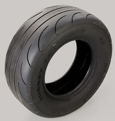

i have 4 fronts black gta all around and wanna run th et street radial what size would i need would it be this one or do they make a bigger 16inch that dont rub?thxs greg!!
or would this fit no rub? and these are the tires everyone likes and runs right?
295's
Brand: Mickey Thompson
Product Line: Mickey Thompson ET Street Radial Tires
Part Type: Tires
Tire Size: 295/50-16
Rim Diameter (in): 16 in.
Sidewall Style: Blackwall
Tire Construction: Radial
Directional: Yes
Tire Diameter (in): 27.69 in.
Minimum Recommended Rim Width (in): 8.00 in.
Maximum Recommended Rim Width (in): 10.00 in.
Tread Width (in): 10.80 in.
Section Width (in): 12.09 in.
Asymmetrical Tread Pattern: No
Tube Required: No
Tire Compound: R2
DOT-Approved: Yes
Quantity: Sold individually.
Yep,255/50/16 is the right size . I am jealous that is what I am wanting now.Good job.
Go with the 255's. The 295's with 12.09 section width won't even come close to fitting with GTA fronts without a frame notch.
Did you purchase the tires recently, and if so, where? Every place I have contacted said they were on national backorder.
I run the 255's on mine. GTA fronts. Works great. 1.701 60 at 4 psi a few weeks ago with a not very track experienced driver. Tires were at 18 psi. :biggrin:
Which compound seems to work the best? R2?
Also, what rim/tire combo works best up front for a street/strip car?
