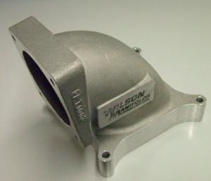

.... why not run an elbow w/90mm Ford throttle body?
T-body?
