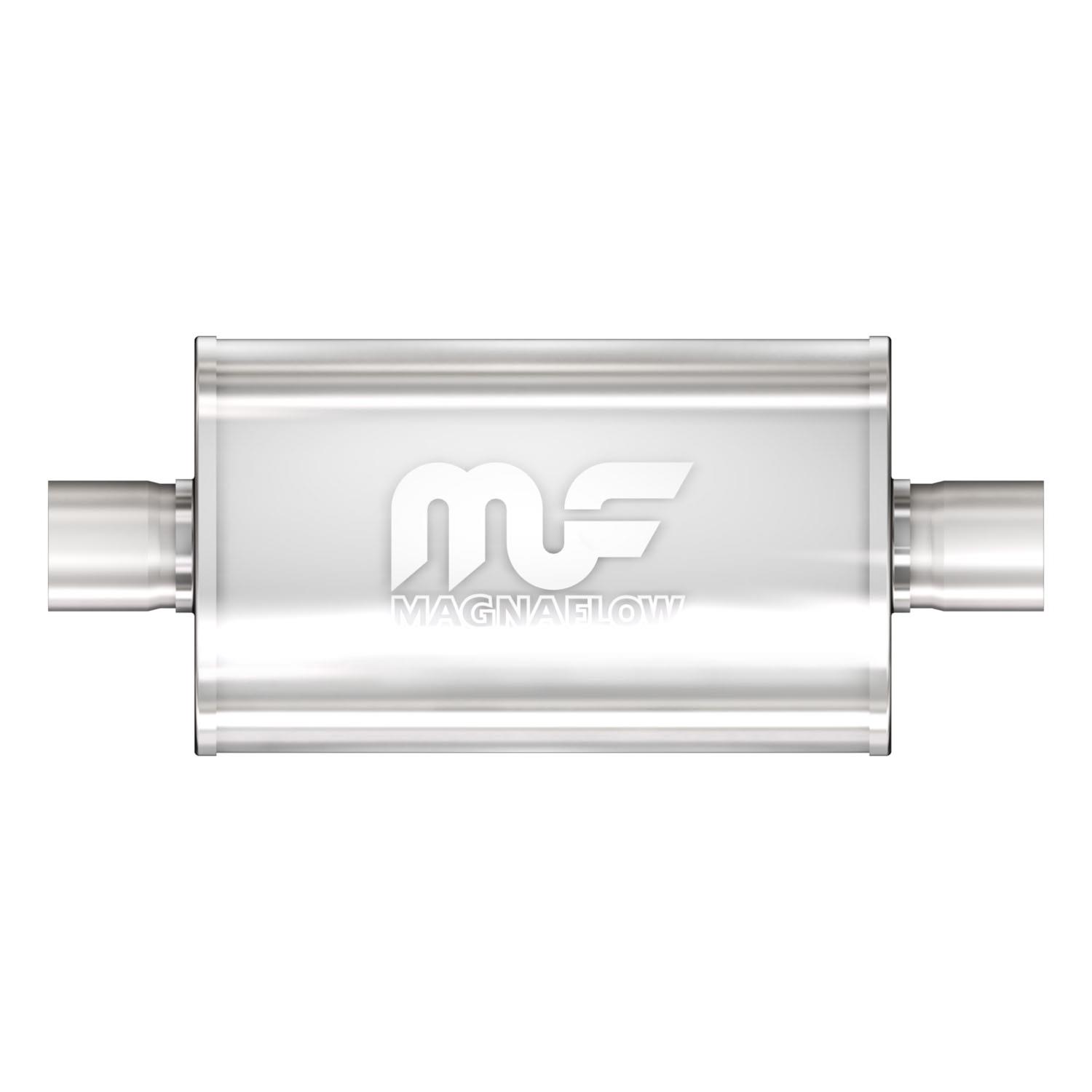

Magnaflow makes a center in/ center out muffler that’s 5”x 8” but is 14” long.
The corner could be cut off and a plate welded on to make it fit.

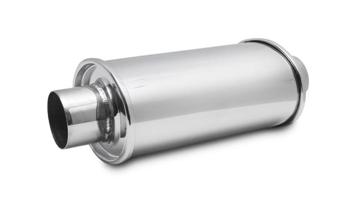

Vibrant makes some ultra quiet resonators that may work as well.
This one is 4 3/4”x 6 1/2”x 9 3/4” long.
A pipe will have to be added to the front side for length, and move the resonator to the back. It might clear without cutting the corner off.
