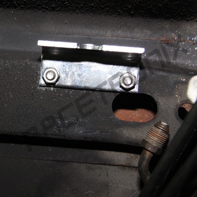

I took my tank down this weekend because i had to fix my sending unit, so I got you some pics when the tank was down
As you can see the lines coming off of the tank are zip tied together. Then they go over the plate near the top of the floor. The lines are run right between the frame and floor in the corner.
The lines follow the corner of the frame and floor, and exit at the bottom of wheel well on the frame. The return line just follows the frame to the front and enters the engine compartment right by the drivers side wheel welland runs up near the master cylinder. The feed comes out at the beginning of the wheel notch in the frame to the Fram filter.
The Fram filter is bolted to the reinforcement part of the floor near the stock placement for the fuel filter.
Then the feed line follows the return line to the engine compartment.

Hey Mike, when you mounted your filter, did you come down with the bolts from within the car?
I did Just installed it put some buytl on a flex gear wrench or wrap a wire around the bolt and fish from the large hole
Also the feed line I had to run along oil pan and up the turbo side of the timing cover .it was to long to go on the same side as the return line
