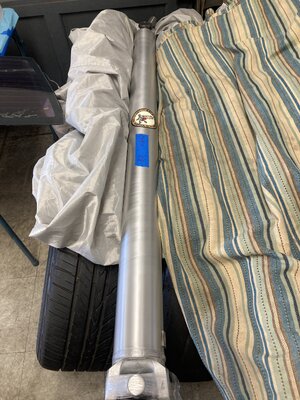

I just got this one in Fairfield N.J. $500 he’s the same guy who makes them for Kirbans.
