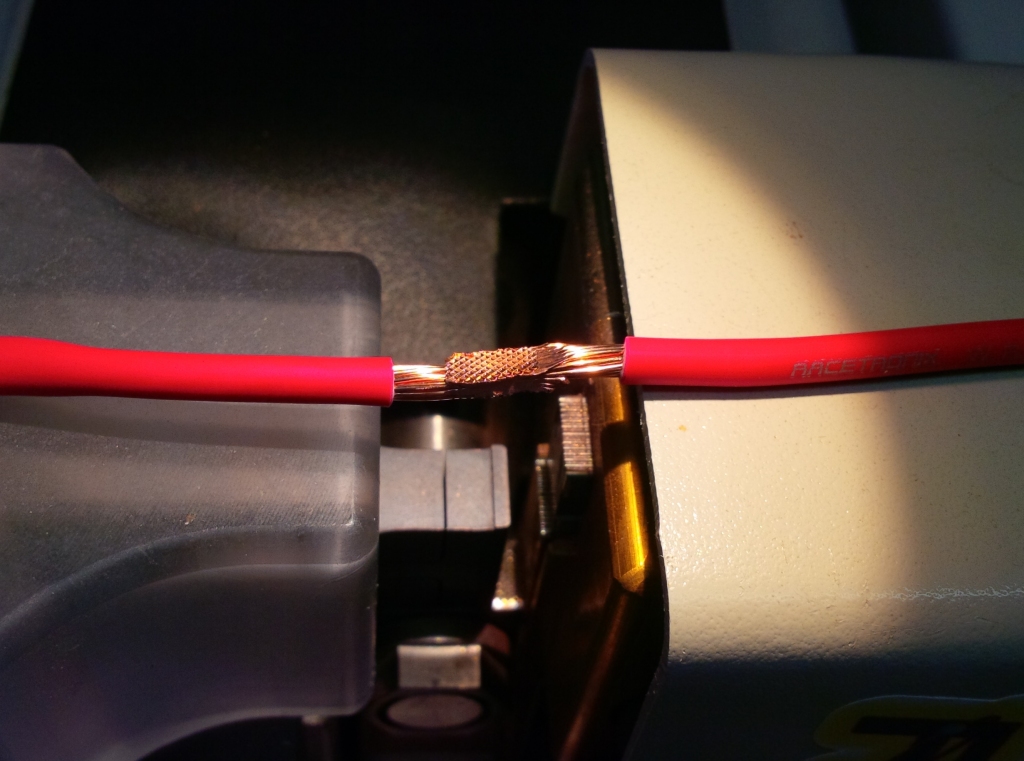

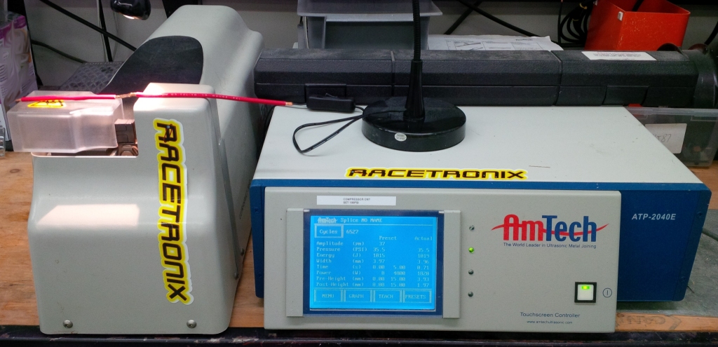

Our G7 hangers are designed with redundant power and ground feeds so the possibility of failure is pretty much non existent.
Our G7 intermediate harness has one 10Ga wire ultrasonically welded to two 14Ga wires which enter the bulkhead connector.
Ultrasonic welding provides a zero-resistance copper to copper bond without introducing tin/lead into the joint.
