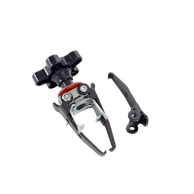

Kirbans valve spring tool is great but I wouldn't use his springs as I have never seen published or tested force results on them.
CC980's test right at the top of the spec. and are very consistent spring to spring.
Just my .02 and by all means get the Kirban tool worked excellent on my 2 cars.
Someday someone will test his springs. :)
Do a search most likely tons of info. on how to do it.
Definately get the Kirban tool. You can sell it later here or Ebay for what you paid for it. Get the Comp Cams 980's... they seem to be the most popular upgrade.
