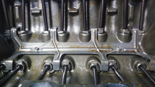

I used to roadrace and had to wire everything on my racebikes, so I tend to use it on anything important that holds back fluids or international fasteners.
Keeps fasteners from backing out and doubles as a visual assurance that they are torqued.
