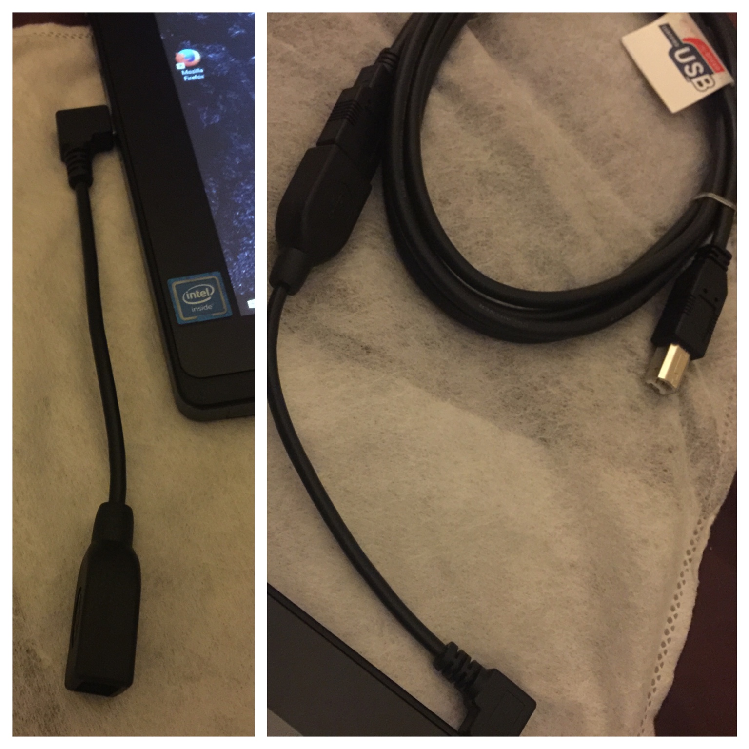

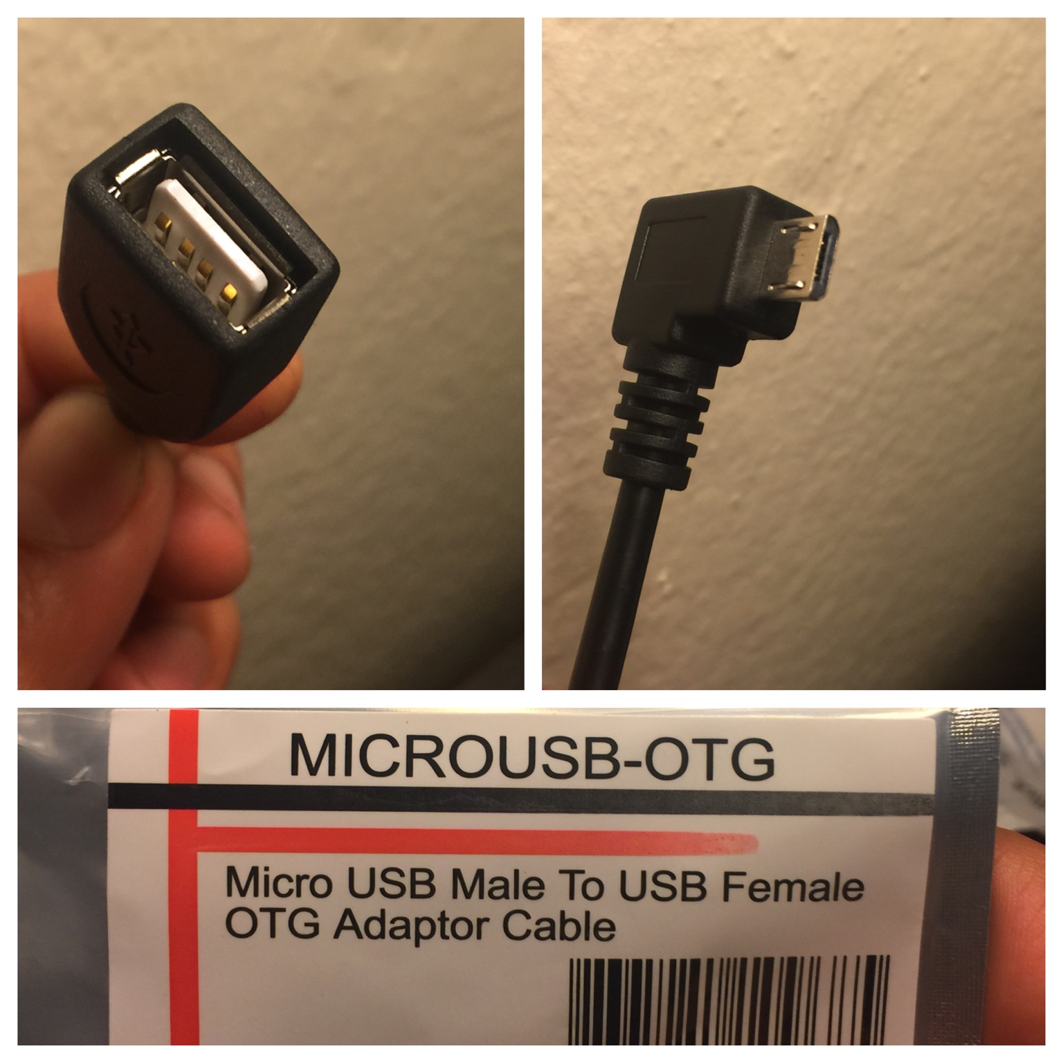

Yes a usb to microusb adapter should communicate properly
"MicroUSB to Female USB"

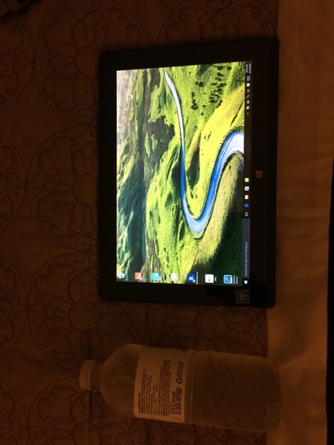

I just picked up this bad boy from BestBuy...
Looks sweet .. I recommend if you're looking to buy one, to get item: Acer One 10 10134 Intel Atom 32GB With Keyboard Silver
Model: ONE 10 S1002-145A 2-IN-1
$159.99
The other items listed in the other similar thread only have 2GB of memory... Don't recommend that.
Before you go make this move, I'm going to try it out and let you know. I'm curious about the resolution ... And while Powerlogger works at 800x600 ... It should still adapt to higher resolutions if this tablet doesn't allow it to be lowered.
I'm hooking up the power logger this Saturday, but I'm going to download the software onto the laptop tonight. I'll let you know
Went ahead and got it on the tablet... Here's the video! Of course. I don't know how it'll work hooked up to the actual Powerlogger in the car because I haven't installed it yet. However, loads up perfectly on the tablet without a problem!
Looks great, tablet detaches easily.

As I mentioned I said we'd need what is called a Micro USB .. Attached are pics. The tablet (when hooked up to the detachable keyboard) does have a regular USB inlet. Of course, however, we want to use the tablet!

Mines working flawlessly. Knock on wood. Connects instantaneously the moment it turns on.
