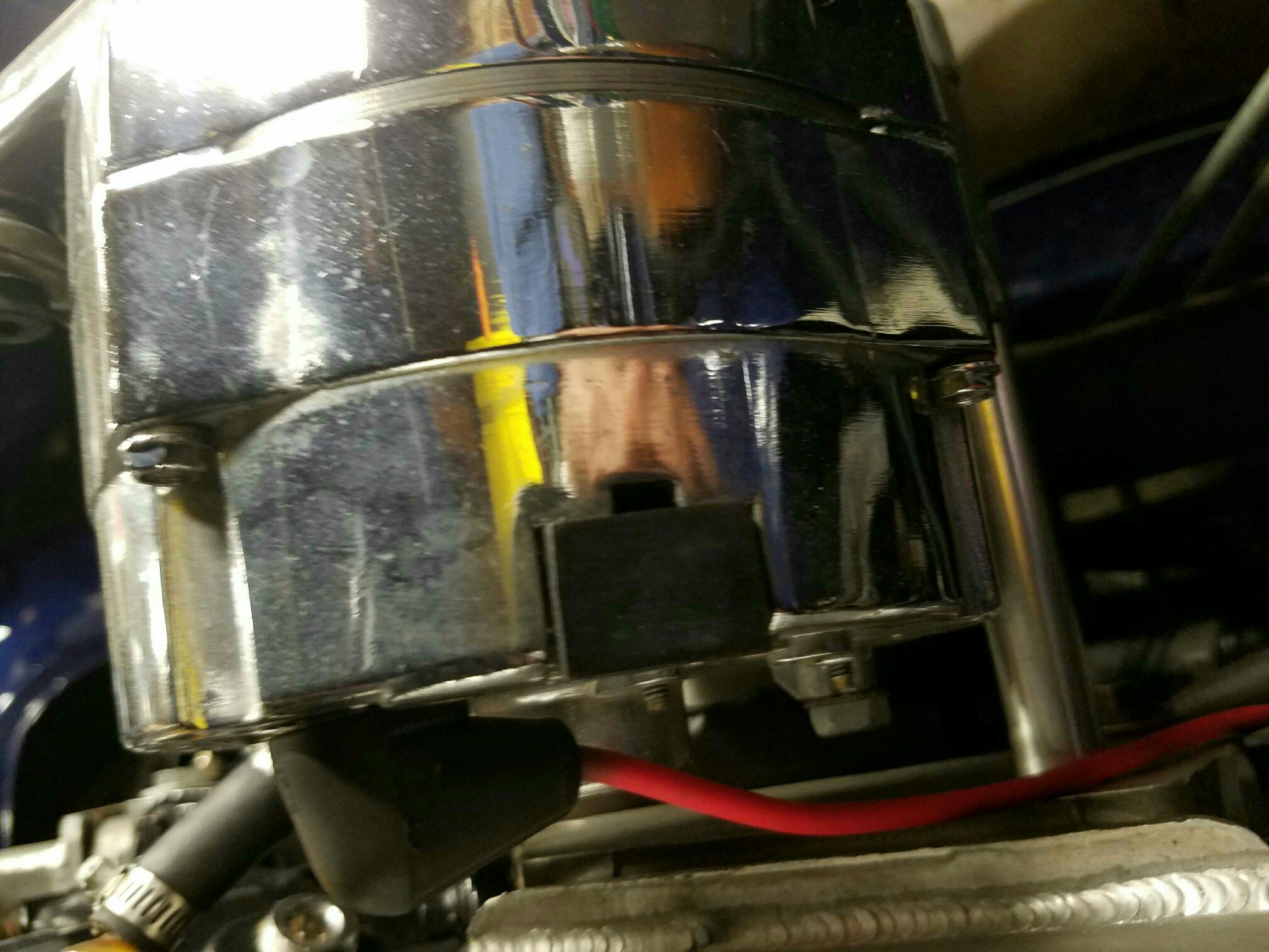

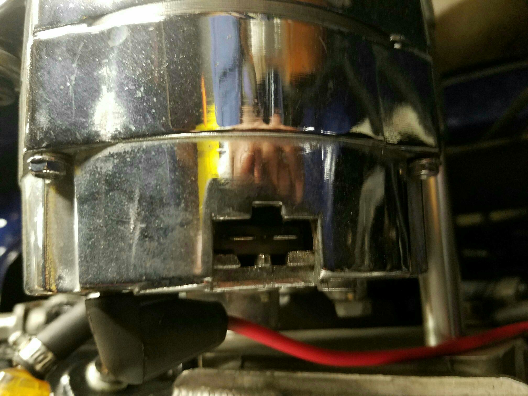

He guys decided to go with a new powermaster 150amp chrome smooth look alternator #37297-313. Received it today and noticed the plugs are different. Powermaster alternator has two prongs on its plug and my stock alternator has a plug with three wires and 4 prongs on the alternator. I was wondering if powermaster had a plug to adapt it but they don't. Powermaster tech guy told me I should be ok to just hook the 2 wires up to the post in the back and leave my stock plug unplugged. Not sure if this is what I want to do. I'm assuming that the wires for that plug go to the idiot light on the dash which won't charge the battery in its not plugged in. I do have the caspers field fix installed so I'm not sure if it's ok to run it with out the plug in. Any one else run into this situation. I posted a picture of the new alternator two pin and my old one and stock plug.

Well guy at powermaster wasn't correct. I started my car with the sock alternator in there. I get 14.4 volts on the scan master. Unplug the plug and 11.3 volts. Dam
Looks like that alternator is not made for a GN, just looking at that 2 prong plug should be enough to alert you
If the builder of the alt says to tie in the 2 prongs to the lug in the back , then the alternator will be putting out max volts all the time and boil your battery, I can only imagine your car going up in flames after driving down the freeway
That same plug is on my 67 bird and it uses a external regulator....
I would return it and get a 200 amp caprice alt
Yeah looks like it's going back. Powermaster has it fitting the buick G/N But I don't think so. Its a nice looking alternator at 217.00.
I have the PM 200 amp on my car and I believe it was 37864. I did the install and don't remember anything being different?
Looks like I'm going to have to go the 200 amp route. The PM I bought was 150 amp $217.00 The 200 amp is over $400.00
Yep I bit the bullet and paid the $419. Of course if you don't want chrome it's a little cheaper.
That alternator has the early style regulator in it. They haven't used that style in years. Send it back and get the correct one.
Probably a 1 wire alternator. They don't require a powered signal to start the charging. It will run without the plug hooked up. But you won't have the charge indicator light without it hooked up. I would also recommend getting the correct fit, but you could hook up the idiot light circuit with a harness from any part store for an old GM vehicle. The signal/reference wire needs to be left off or the alternator field stays powered and will kill the battery.

The cases are standard GM Delco alternators. The regulator is the only difference. Usually they come with a cap over the regulator terminals, but they are still there
