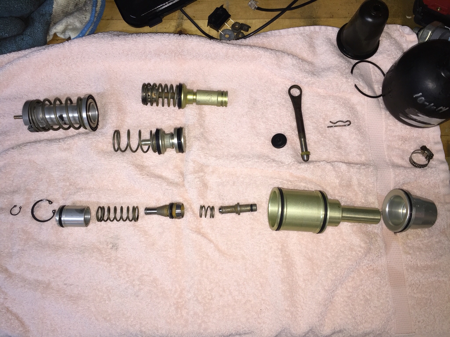

PM started acting a bit strange, but unlike most, I decided to troubleshoot and found an internal leakage issue.
Got it tore down waiting for seals.

Very cool pictures. Send more as you put it back together

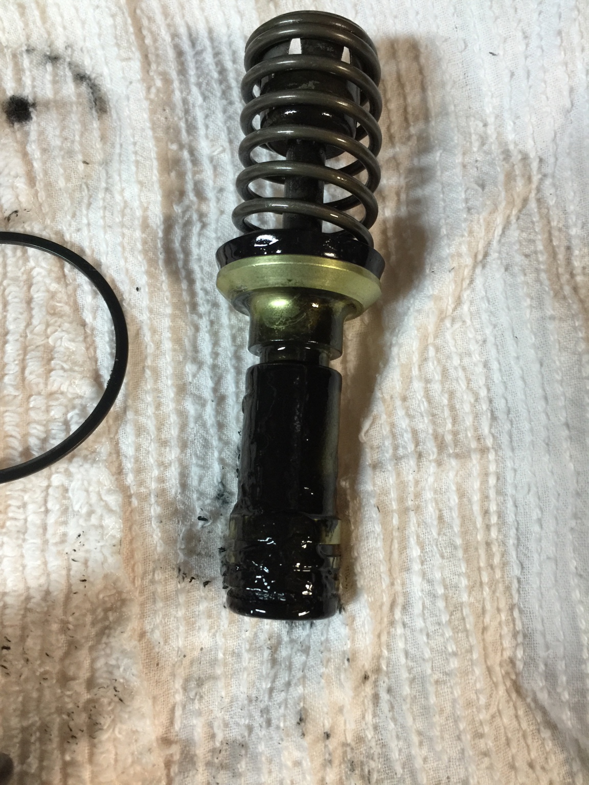

Already did the port B test and it was fine. Port A failed indicating an internal master cylinder leak. Most of the o rings on the power piston are shot.

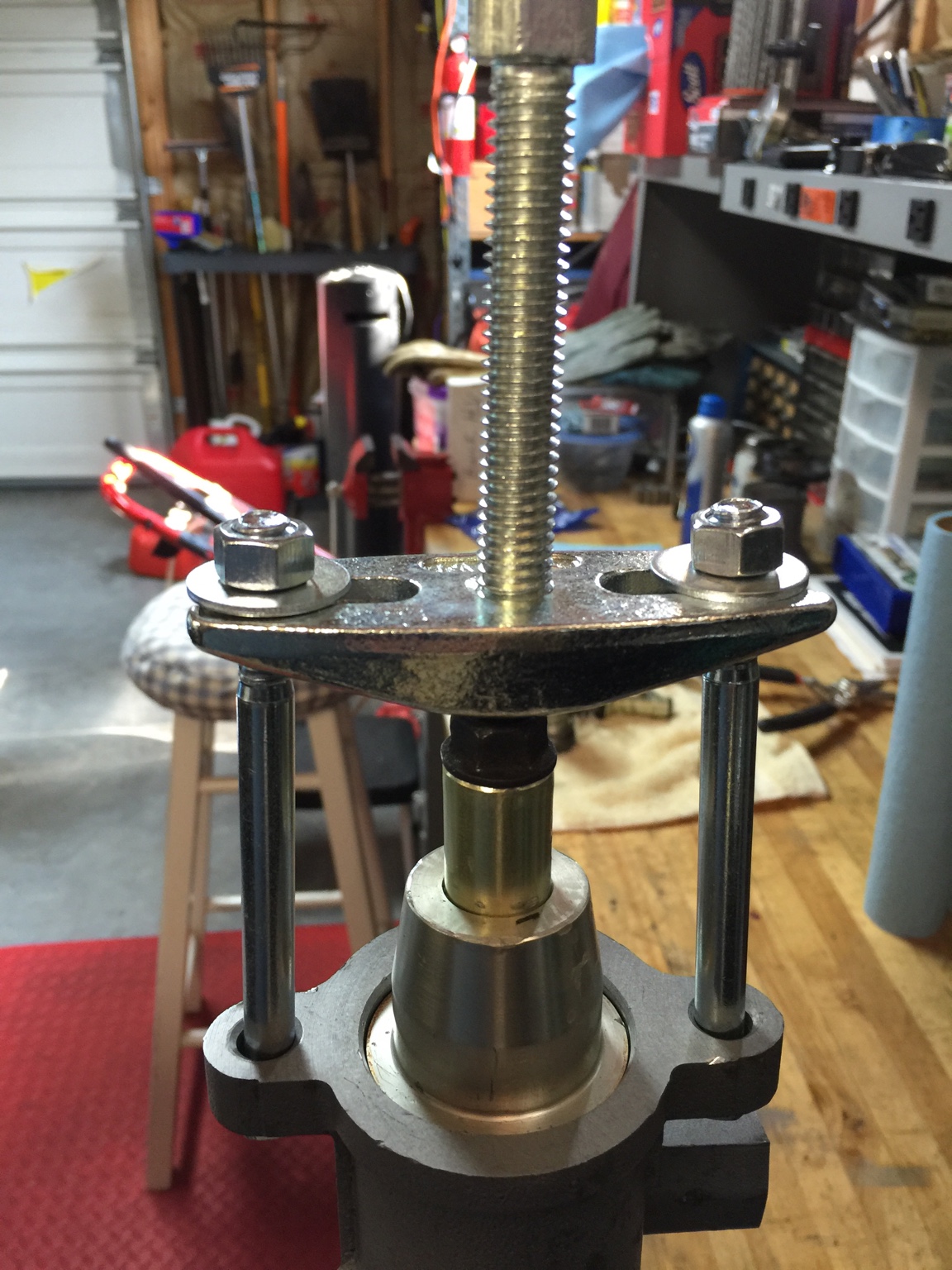

Teaser for those of you that have rebuilt their own PM and struggled with the zip tie method.
