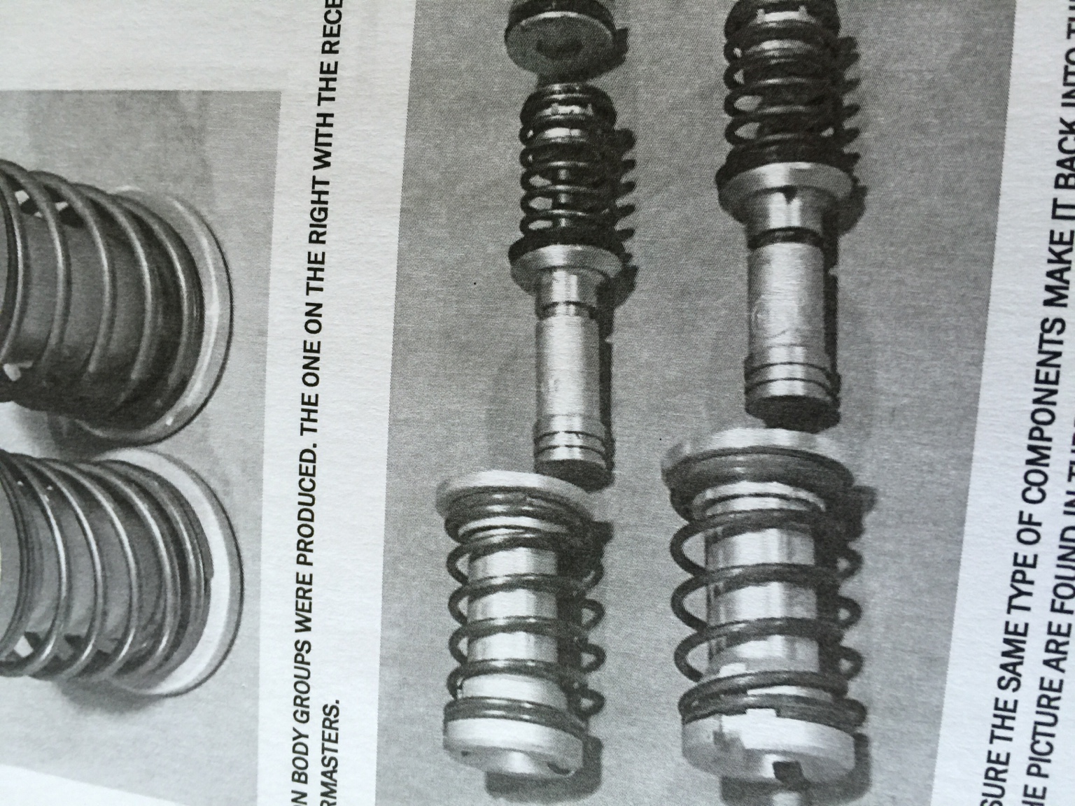

You didn't disassemble the two larger parts with the large external springs did you??
I'm referring to these parts with the lip seals.
They only need cleaning, not disassembly.

Correct. Those parts in the picture stayed in tact. I just cleaned them. If I had a picture on hand I would show you what I mean.

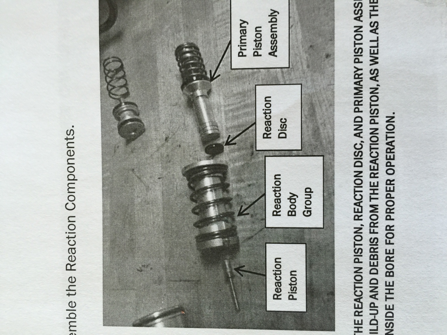

Here's a picture of the primary piston, reaction body, and secondary piston (top of photo).
The only requirements here is to pull the primary piston out of the reaction body, and pull out the reaction piston.

Yikes... My primary piston doesn't look quite like that. It looks like the primary piston assembly is not supposed to come apart. My spring doesn't have any sort of retainer.
When I pulled mine apart the primary spring was where the secondary piston spring goes ALONG WITH the secondary piston spring, so the primary piston didn't have a spring at all. I put the spring back in the correct spot, but I guess it's still not going to be right unless I pull the PM apart again and replace the primary piston with a good one from another unit.
