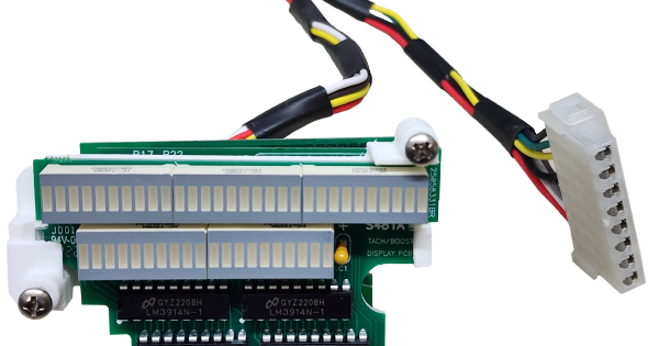

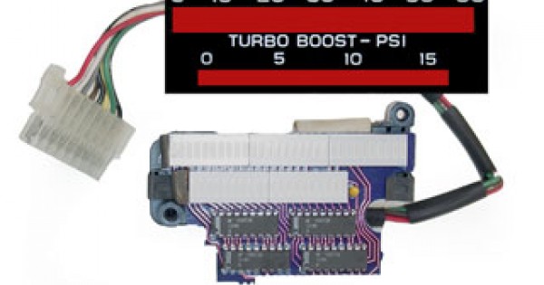

If the tach display and/or boost display goes to full scale or close to it, the unit is defective and needs to be rebuilt.
They all will fail in this fashion eventually. Genetic defect causes this to happen.
Caspers Electronics will repair it, or offer a replacement part.
Read about it: http://www.installationinstructions.com/FYI/tachboost.pdf
or
I have installed a couple of Casper's replacement units. They are not exactly the same in terms of the colors of the lights/bar but they are close and a nice replacement, the only thing out there that I am aware of for this issue.
>>They are not exactly the same in terms of the colors of the lights/bar but they are close <<
The original LEDs are long gone and obsolete, so the next best colors were chosen. They're much more efficient than those 80s LEDs and will last forever.
I was very happy with the two sets I purchased and installed from Caspers. I would purchase again.
