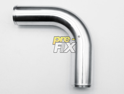

Just wondering if you guys that went aftermarket and cut the pipe which seems like a great option, did you roll the lip so that the hose will stay on better. Or did you have luck with that? Staying on and a nice tight clamp. Don't want it blown off while I'm blasting down the road. By the time I buy the pipe, cut it and roll the edges, I'll have $150 into the pipe. Great ideas but I think I'll just wait and hopefully PTe can come through, eventually

if you dont bead roll it ...it will pop and could mess up the hood liner and if your lucky you wont dent the hood . it sound like a tire blowing out .
bead roll the ends
Back in the day we use to spray Hairspray on the up pipes under the rubber cuplings before silcone and good clamps but i wouldnt trust that nowadays.
None of that matters with the right hoses and clamps
Once your pipe is cut to length and ready for install maybe go to a welding shop and just have them add a bead shouldn't be more than 10 or 20 bucks or some beer. That way you don't have to buy a bead roller
