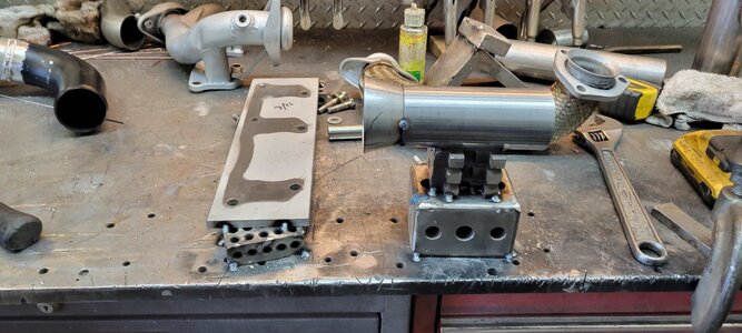

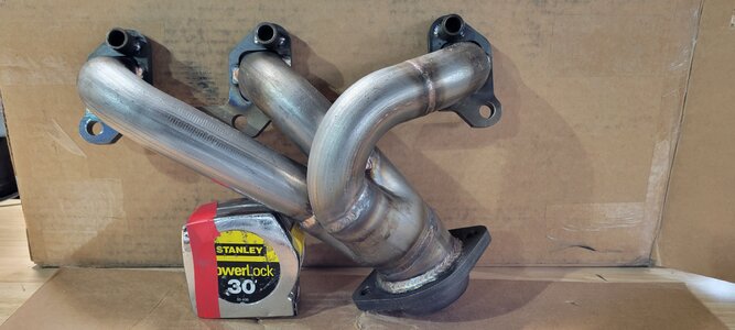

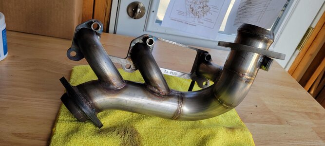

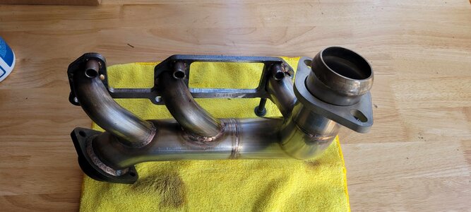

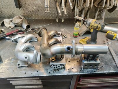

If you still have the stock exhaust manifolds installed, replace them with a set of Stainless Steel TA Performance '87 Stock Headers then modified the turbo up pipe to fit your turbo. With a little bit of fabrication, you can keep the stock up pipe or fab a new one. They will flow a hell of a lot better and eliminate any exhaust leaks prone to happen on the stock exhaust manifolds. Extra care needed in making sure the AC Compressor is not compromised. TA Performance Driver Side Header.jpg
Driver side
Passenger side mod
passenger side mod with ball & socket flange
Modified TA Header PS Jig
