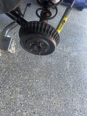

Yesterday at 11:52 AM #1 D Dhos1 Self-tuning wanna-be Joined Apr 14, 2012 Messages 1,420 How to remove the cover I don’t remember how I got the other side off Attachments image.jpg 2.5 MB · Views: 6
Yesterday at 12:32 PM #2 S slojim New Member Joined Nov 3, 2024 Messages 6 I think there's a plug to give access to the adjusting wheel. You may have to adjust it out quite a bit if the shoes have worn in to the drum
Yesterday at 1:12 PM #3 D Dhos1 Self-tuning wanna-be Joined Apr 14, 2012 Messages 1,420 I got it by beating the shit out of it. The pads were so with the they stuck to the drum itself
