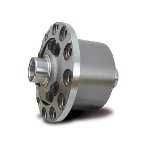

stock 3.42. Eaton regular posi lock is very good 28 spline. Trutrac if you are going for higher hp. Regardless go with aftermarket axles. I prefer Strange.

The eaton stuff is nice but that off brand yukon stuff works too. There is Brian Trick who can be contacted on facebook or V8buick.
