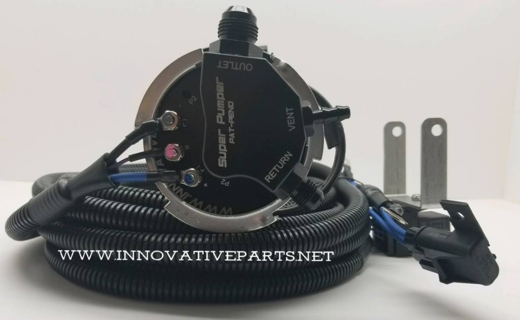

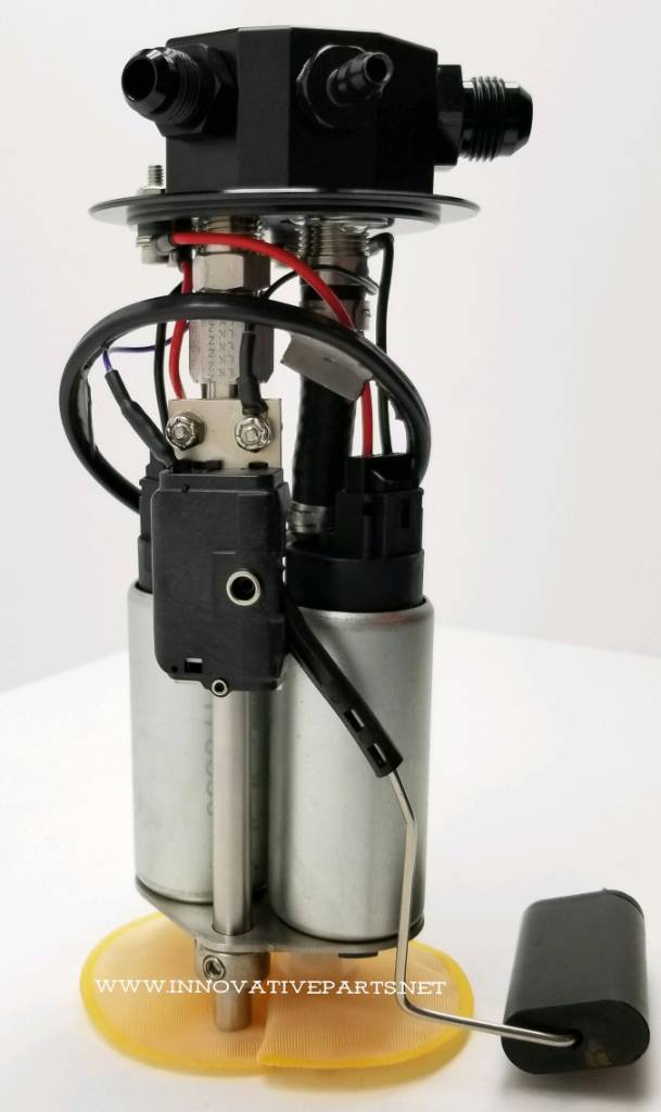

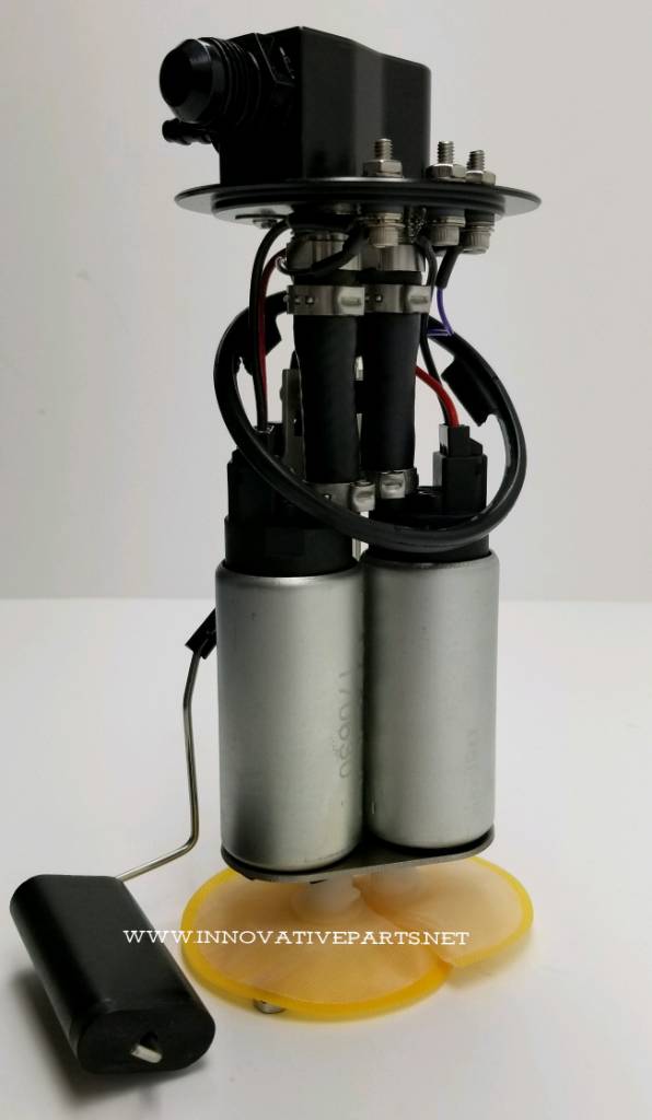

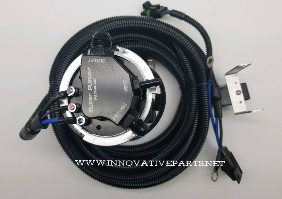

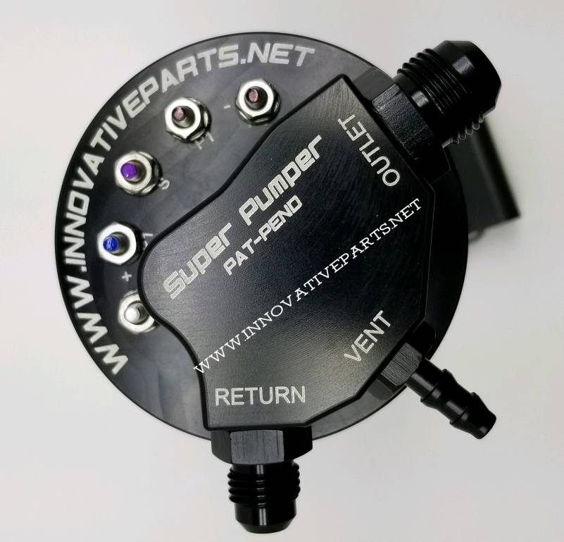

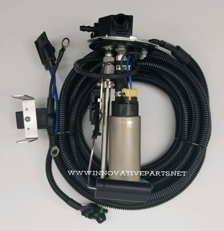

Other options besides that cheap racetronix unit.
Puts the racetronix one to shame.

Cheap?? You seriously need to stop that. I am running that system for years with no issues, and my car is faster than a good majority of cars on here and have not taped out this system yet. If I haven't maxed it out, then 90.% of the people on here have nothing to worry about. I normally don't get involved in threads like this, but your comments are taking things too far and it's bullshit. You gotta stop the witch hunt and let vendors products stand on their own merit. If you don't like the company, don't use their products. This is my best friends company your bashing and you don't see me ever doing what you do on here to any other vendor that is a competitor on here, because there is no reason for it. There's enough room in the sand box for everyone to play and coexist. Options are a good thing for everyone. Every vendor deserves to eat.

Not bashing racetronix at all. I've used them for a very long time. They make some killer stuff but that hanger is not as good as it could be. If they made the hanger I'm sure it would be a killer piece but it looks to be China made. Also the wiring and using that yellow bulk connector with those small pins has been cover. I say cheap because I know it could be better. Anyways just stating other options out there with better quality and 100 percent made in the USA. Can you get away with either sure. Same thing with the China gas tanks.

Lol, right...... Not bashing. I just happen to have product pictures at my disposal too. Lol , classic... Chinese garbage, USA made, come on man,

I will offer this to guys out there. There is nothing cheap about the Racetronix double pumper. Jack at Racetronix might be a good buddy of mine, but that wouldn't justify me using a cheap product on a car that I have invested my left testicle into. The mere notion that I would is ridiculous, if anything that would put a rift in our friendship. I have taken this system to 154mph in a heavy car with a 68% duty cycle years ago when I was making far less power than I am now. The fact that I have not seen any limitations in this system imo speaks volumes, and the beauty of it is it is just as streetable as the stock system. It can go on a 12 second car to a mid to low 8 second car with the same reliability and comfort. No down sides to investing in it. And just a little food for thought. Jack has a electrical engineering degree and worked with Motorola back in the 80's, so to suggest that his system is less than adequate from the stock unit is ridiculous. Every aspect of this wiring harness was inspected and tested a thousand times over before it ever became a product that he sells. Buy with confidence if that is a choice your willing to entertain.
