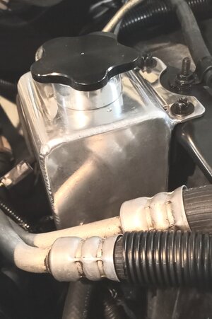

My cheap solution was to buy a Speedmaster (Procomp) universal GM remote resevoir (about 50 bucks) and change the bung to the proper size of the feed hose, and reinstall the return barb at the angle of the original plastic one.
The return (small) barb needs to be angled like the original so as to swirl the returned fluid, rather than shoot it straight up towards the cap. The Speedmaster unit has a coarse screen to disburse the return stream, but a quick test in my parts washer showed that wasn't sufficient in my opinion.
Buy the correct size aluminum hose barb online, and take it and the old plastic resevoir to someone with a heliarc. It took me about an hour to modify mine.
I modified the mounting bracket as shown to clear my cruise control hold down strap, and drilled 2 holes in the bracket to accept self tapping screws.
TIMINATOR
