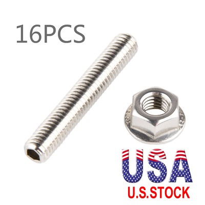

the very first bolt that I torqued (15 lb/ft ?? - wasn't much) pulled the aluminum threads out of the intake. IMO, those factory bolts were not catching enough threads once the PP and additional gasket were installed. I ended up getting some longer stainless studs and factory-style flange nuts off of ebay to fix it.

I ended up using M8 x 1.25 x 60 studs on everything like you mentioned. I looked on Ebay, but can only find them in 50 mm length now. The 60 mm bottomed out in the hole and helped me to avoid heli-coil on the one I pulled the threads on. The 50 in the link below would work fine if you haven't already messed them up.
I wouldn't recommend serrated nuts on an aluminum plenum. They will rip the crap out of the casting every time they get backed off.
