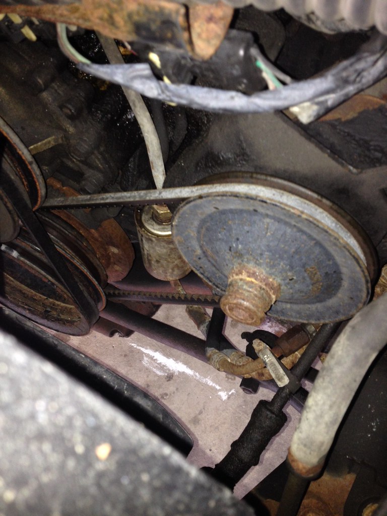

Posting for the Hot Air crowd, filter is not by the frame rail it is in the front of the engine behind the fan on the driver's side:

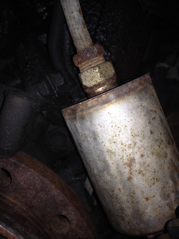

If yours is a rusty old POS like mine then make sure to get a couple GM fuel line repair kits. I used a generic GM repair kit Dorman 800-153.
Because the filter is upright, moisture will just pool on the top make removal impossible.
I PB Blastered it for three days twice a day, used the correct 5/8" flare nut wrench and still ended up cutting the damn thing out. Fortunately the repair kits come with a compression coupling and are more than long enough to replace the section you cut out.
To prevent the threads from seizing up again use some PermaTex with PTFE, it is gasoline safe and stays softish so the next time you need to replace the filter you won't have to be pissed off for three days...
**quick tip** save yourself some time and remove the radiator/fan shroud. There are no awards for least number of parts removed.
I would take one look at that and nope the fuck out of there in a hurry. That thing might as well have been welded in at the assembly line.
