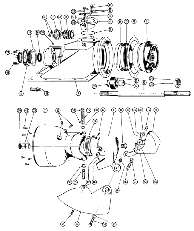

Fast forward to when I rebuilt the jet in my BBC jetboat. The Berkeley jet uses 5 rope seals around the shaft to seal out lake water. (part #24). It has a clamp that adjusts the compression to squish the 5 rings against each other and squeese the shaft firmly (giggidy) #7. When done correctly you get right at one drop of water per second entering the boat. If you don't leak, the seals get smoked with a quickness.
Also, there's a rubber lip seal (#26) to keep water SEALED off from the very important thrust bearing #32.
Moral of the story, lip seal, good... rope seal, leaks. :D
And after typing that I recalled a guy with a lathe make a UHMW sleeve that used plain ole rubber orings to seal the shaft to the housing.
It's almost like rubber works better than a rope packing gland. :D
