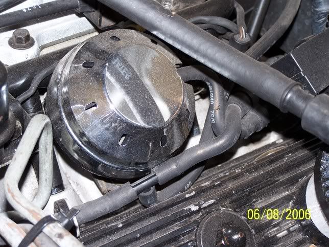

All of that to ask this... I don't have my digital camera (we moved recently) and I think I have a vacuum line unplugged. By the valve cover breather on the driver's side, there's this truncated cone looking thing, and it has a vacuum line going to a connector right by the breather. That line is just flapping in the wind as it is now, I don't know how long it's been that way. Is that my fuel pressure regulator? I tried finding a stock engine bay picture so I could point it out here, but I can't find one.

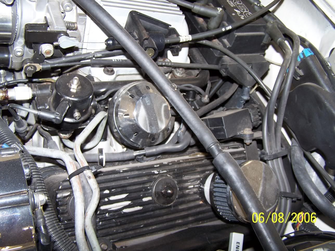

Well, I do have a hose sitting loose, but I don't have a clue where it goes or what it's suposed to route vacuum to. I'll take a picture of it with my cell phone and attach it in a few.
Here's my hose... Don't know how long it's been like that... :confused: :rolleyes:
And yeah, I know it's dirty. What can I say - it's a high-mileage daily driver...

Hey, cool... but uh... what is it? (wish my engine bay looked that nice!)

What do you mean what is it? Its the same pic you took but my car doesnt have any loose hoses? Yes the hose you have goes to the nipple that you have in yellow.
Jason :confused:
Ah. So I'm assuming I have a ghetto EGR-delete mod, then? Or do I have an always-open EGR?
The EGR on my car is not working, but I still have it there. Just plug the hose in and let us know.
