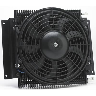

Even though you bought the wrong radiator and fans, I think you can improve your situation in a noticeable way with an external transmission cooler. If you run the hot tranny fluid to the radiator first and then the external cooler, which is what all of the manufacturers suggest, you won't notice any improvement. You must run the hot fluid to the external cooler first. Your biggest problem is the temperature of the coolant leaving the radiator. If it is not below the temp of the thermostat, you'll never get it down to 160. In order for the thermostat to get the coolant down to 160, it must be fed with coolant that is colder than 160. You're sending hot trans fluid to the radiator which puts a load on the radiator. If you put less of a load on the radiator, the radiator and cooling fans won't have to work as hard. If you are still using the engine oil cooler, you are adding that workload to your radiator and fans as well.
Step one - reduce the workload.
I still have the stock radiator fan, but I don't run voltage through the resister. I have an F body radiator which has 1 row of 1" wide tubes. It doesn't have the engine oil cooler but it does have the trans cooler. I installed the external trans cooler 3 weeks ago and ran the lines in such a way as to first send the hot tranny fluid the radiator cooler just as they recommend. I saw no difference in coolant temps even when i turned the cooler fan on. It would just get hotter and hotter and wouldn't cool down from when I put the trans in park and let it Idle. One week ago I rerouted the lines to send the hot tranny fluid to the external cooler first then to the radiator. The results were noticeable and shocking. Not only did the engine run cooler, when I parked the car it went down to 163 degrees and the radiator fan shut off. That is the first time that has happened since I bought the car 35 years ago. The next time I drove the car it was 85 and quite humid and I turned on the air conditioner And once again was shocked at what I saw. I think it got up to 172 as I pulled in the driveway so i put it in park and let it idle with the a/c on and the temp came down to 169. Then I turned the a/c of and let it continue to idle and watched the temp drop to 165. The I turned the heater on and watched the temp drop to 163 at which point the radiator fan shut off.
For all these years I've never been able to get the temps under control the one thing that changed everything was the addition of an external trans cooler plumed the exact opposite way that they recommended.
