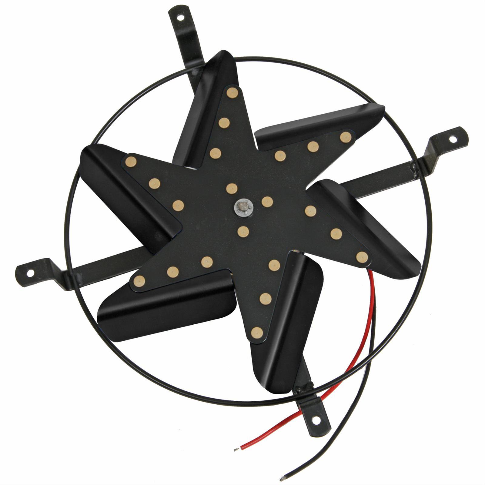

Have Tony make you a duel fan shroud with the spal or your fans. Didn't i show you the one he made me?
I also have my new duel intreped fan you can have
Ha ha. Nope BLDC fans, they move a shit ton more air cuz of the load curves with little RPM drop. Maybe 1.5x more flow.
